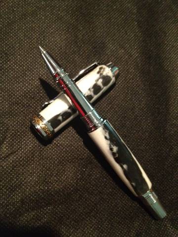

Joe, I've finished a couple of gator pens, CA'd and not CA'd. I definately prefer the finish with CA. I use 20 coats of thin, then MM.
