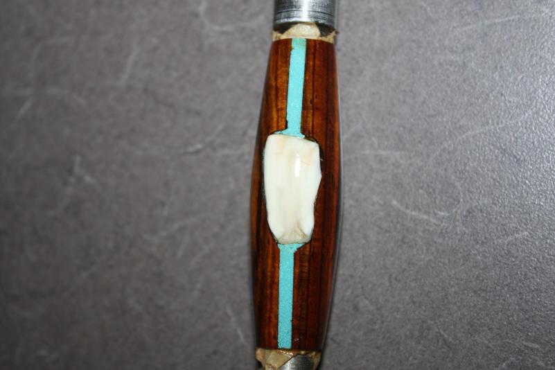

I have a question. I am finishing a pen that I have turned out of Koa that I have had for a couple of years. I like using Minwax brand clear gloss Polyurethane as the finish. I applied the finish on Wednesday and on Friday it is still tacky. Is this normal?

Well at this point I am probably going to just bake it to speed up the cure time. I origionally tried to use CA but the oil in the wood was bleeding into the Turquoise inlay. I have enclosed a picture to show my work.
