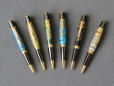

I just got done with an order for 16 pens and am trying to get it ready to ship. Wish my cat would quit popping the bubble wrap.
I didn't photograph this batch but here's a photo of some from the last order.

Wow,that's a lot of pens at once.
How long did that take to complete? I'd need to take a break after an order like that.
The ones pictured look great!

Thanks. Circuit board pens are easy to turn and don't take much time. I had them turned in two days and buffed them on the third and packaged on the fourth. Obviously I only worked on them a couple hours a day. This is my second order of 16 in two months.

Awesome job on those pens. Every one who sees them wants one for sure.
I have had to go to cutting them at a very slow speed. About 900. I use a roughing gouge turned at a side edge angle to the pen blank, if i cut normal they shatter every time. I have been able to repair them with CA.
Get mine at WC. Any one else carry them? They also were not carrying replacement blanks for the kit.
