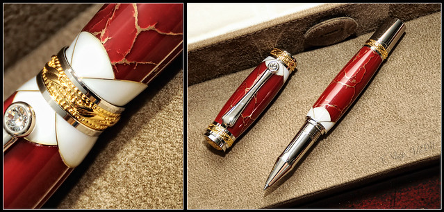

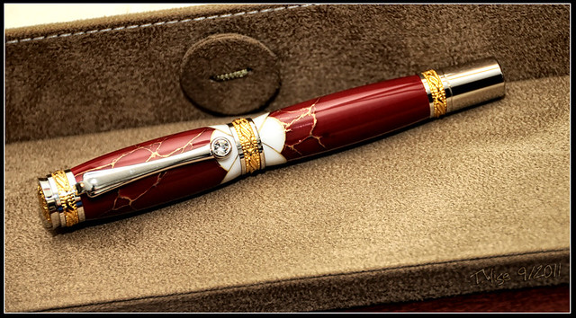

My kit showed up on Friday afternoon so I was able to finish up this pen. As stated in a previous post...I wanted to try out a design I had seen other pen turners do with scallops. Basically sanding or cutting an angle onto the end of the pen blank and adding a contrasting material. I like the way this turned out and had fun learning something new so my thanks goes out to those who have inspired me to try this!
The material is Tru-Stone with a gold matrix running through, white resin slabs, white styrene sheets, and brass accents to pull the scallops into the gold matrix on the Tru-Stone.
Enjoy

This was the "Red with Gold web" sold on exotics. These are very nice to turn and if you micro sand it the results can be stunning with minimal effort. Hope that helps...

As with others I think it's beautiful. I also like the way the matching patterns meet in the middle of the pen when capped. You did well!
What about the lines on the side we saw in the earlier post? Or am I confusing this with someone else's posting?

Same one. You just don't see it that well in the angle of the picture I guess. If you look close in the image of the zoomed in center band you can see the styrene and brass sheet inserts. Again, I think it's just the angle. Truth is I made more work fo myself doing the styrene, brass insert in the center since I ended up using a very thin strip of matching Tru-Stone in the center. Just didn't need to do all of that I guess. I just like learning and there's no better way than jumping in head first I guess:biggrin:

Just ran a guide line down the center on each side and sanded at a 45 degree angle and then used CA to attach the accent then the contrasting white. I sanded flush against the Tru-Stone each time I finished a scallop. Hope that helps...it's just the way I did it. I'm sure there's an easier way, but I'm a little thick headed at times:rolleyes:

Well, let me see...Sand angle, glue brass accent, glue white accent, sand 4 different overlaps and then the other three per section...so that's 56 steps just for the scallops and that didn't account for the steps it took to cut the original blank into thirds lengthwise and add the two sheets of brass and two sheets of white stryren. It sounds like a lot, but truth is...it was fun!:biggrin:
Now this pen will go into a Bubinga felt lined display box that will sit in my closet and collect dust.:redface: Sad but true! I make these just to make them for fun and perhaps one day I'll give them away as gifts or sell them...not sure. Just loving the hobby of turning and I've been doing it for close to a year now.
