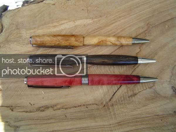

i finished 3 more, from the top, a modified slim olive root burl, then a
BOG wood, then a red cedar. the cedar is from the wood you saw in the picture of the buffalo horn pen.
thanks for looking

Three very nice pens. I especially like your modified slimline. I've yet to do one of those. Can you describe your process for making it? I like this one more than some I've seen.

thanks everyone, Gary, when i started turning steamline pens, i bought a set of bushings, where the center one is larger than the bushings of a standard slimline. so i set the first tube with 2 slimline bushings, then add the larger bushing, the top tube and a slim bushing and turned as usual. thanks again.
