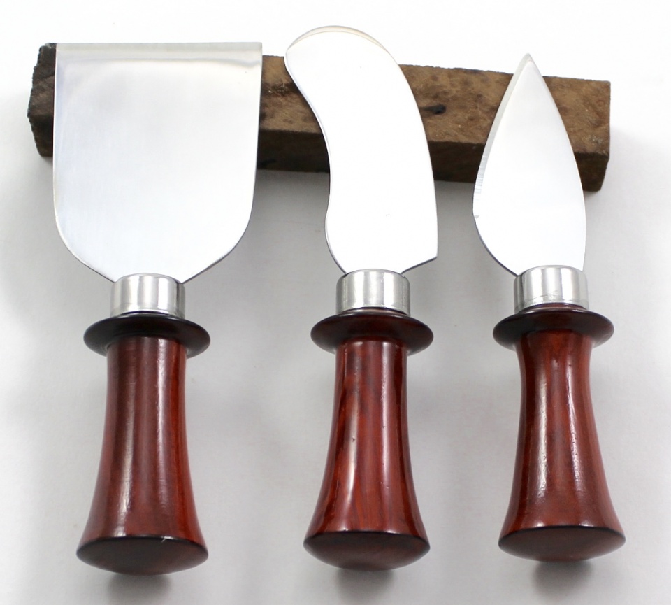

I made 17 cheese cutters (stainless steel inserts) this year and used Spar Urethane. Takes a long time for the urethane to cure, but after 3 weeks they all feel good.
Last batch.
