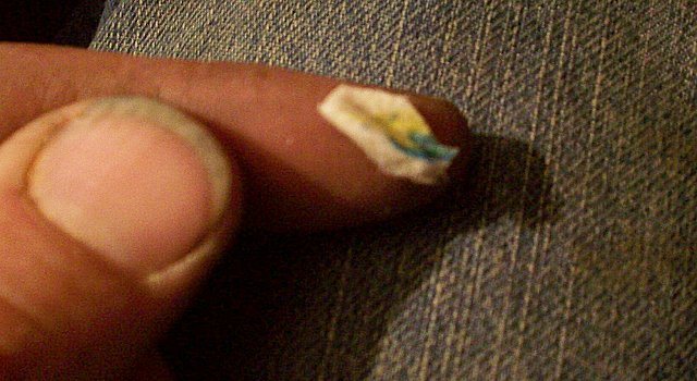

After the fact from personal experience, a disposable rubber glove before the fact would have been a lot easier for me. Medium CA also soaks through a paper towel quite fast and it does set HOT. Finger nail polish was slow, but it got the paper towel WAD off my finger. I now have Acetone and rubber gloves. I have peeled rubber occasionally, but reaching into the box is a lot easier than waiting for new skin to grow. That towel is solid. I used clippers to get it small enough to operate. Lesson learned!

Suggestion. :D Buy Nitril Gloves.
And, ouch that looks painful.
I used latex gloves for a while till the same thing tried to happen to me. I got lucky and got the glove off fast enough. I now use nitril gloves.
