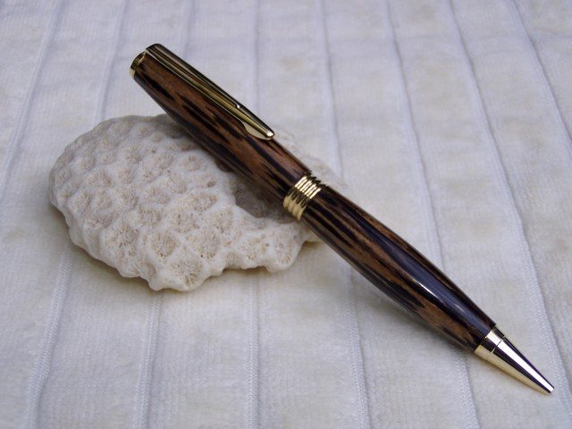

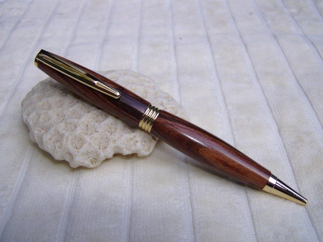

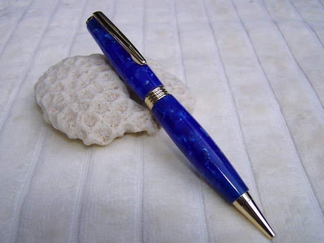

After a few weeks of inactivity i'm now able to turn again. I was so enjoyed that i've turned 3 pens today.
They are all made with the Basic kit from Starbond Europe.
The one in acryl is my 1st attempt with this stuff, and i like to thank all of you who gives me nice tips to work this material :)
Black Palmira
Kingwood
Acryl blue

I like the first one- it has a great pattern.
Is this kit similar to a slimline? They kind of look a little bigger/thicker than slimlines.

Look nice, you may want to use a standard slimline center bushing and underturn the blanks. Looks like the fit is off a hair because of the beads on the centerbands. Also, when your acrylic blanks are off by said hair, you can put a drop of thin CA on a paper towel, then dab it on the ends the barrel trimmer hit. It'll darken the blank so it's not obvious.

Thanks for the tips Skye. If I understand, you mean that where the centerbands comes the wood is to tick [?]
Good tip for the acryl blanks.
