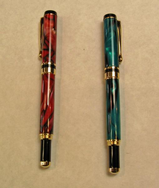

So after many attempts, I have finally completed the first two pens that I think are good enough to sell. The fit is good, the finish is good, and although I could get nitpicky with my eyes 2 inches from the surface, these are hand-made, not factory-made.

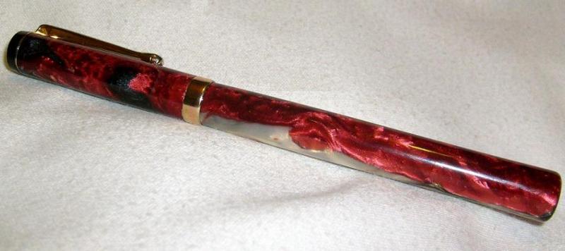

Nice pens! Allthough i dont care alot for the fit and finish of the metal components for this kit, I have made my fair share of em! It is however, a REALLY REALLY fun kit to modify! You can use a drill bit and drill out the cap material super carefully, and "tuck" the part of the CB where the accent rings normally goes. It makes the CB smaller, and sleeker looking. There shuold be a red black and white closed end pen in my gallery with said mod. It is also a really fun pen to make closed end (Hence the closed end, modded CB pen in the photo). I will go find the pic, and thumb it to this thread for you! fun kit to play with for sure.. Probably my one of my favorites despite the bad finish on the metal.
RAdams
Banned
Apr 5, 2009
2,983
something like this

Thank you, everybody! RAdams, that's a beautiful pen. I want to learn how to do closed end pens, but I'm still struggling with the easy stuff!
Parting off for the center band wasn't that difficult for these, because the width of the parted-off area is just about exactly the width of the parting tool blade. The hard part is keeping it clean, I guess.
My biggest problem has been mastering the use of the skew. I still haven't quite figured out how to hold and use the skew.
