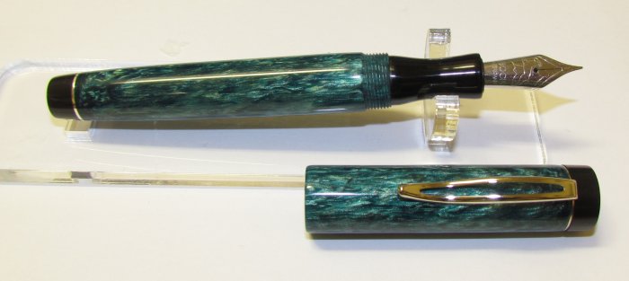

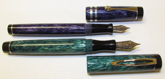

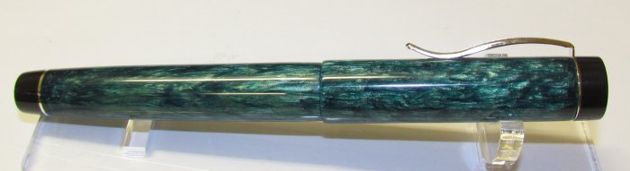

I've been wanting to make a little larger pen, both housing a larger section and a little extra girth and length. After some tinkering and adjusting here and there I finally think I have what I want. Bock #5 and Bock #6 nibs shown.
The purple pen is shown just for a reference to the size differences and is the basic size I have been making.
Any constructive comments or critiques welcome.

Wow, George! Just WOW!
Let me list all the things I like:
  • The clip--you must have made it.
  • The section--pinched in the middle--sooo nice!
  • The metal rings--you guys with metal lathes have an unfair advantage!
  • And the material--especially the green. Is it PR?
Please keep posting your work!

Wonderful work George. I especially like the 'trim' rings that you include. It completes the look and makes your pen that much more distinguished. Very well done!!!!!!!!!!!

First, the clip wasn't made by me but I love it! The section, I agree, this is hands down my favorite shape. The ring on the bottom is .025" sterling silver and the ring in the cap is the ring on the clip. The bands and rings in the purple pen are also sterling silver. The blanks are alumilite blended by me, I like the subtle "grain" which I think goes well with my pens.
As for the metal lathe, well you might be interested to know that this green pen was made 100% on my Jet mini wood lathe! :)

Looks like you achieved your goal. I'm guessing the cap threads are 14mm. Very nice color in this blank. I like that clip. Seems to missing a couple of bands :biggrin: Kidding of course. Just the right touch on this one. I like what you've done with it.

Now that I am happy with the general dimensions, I will be making the double banded version as well as the non-banded version like this one. I don't want to waste silver on pens unless I'm happy with the shape.
Yes, the large pen uses the 14mm triple-start threads.
