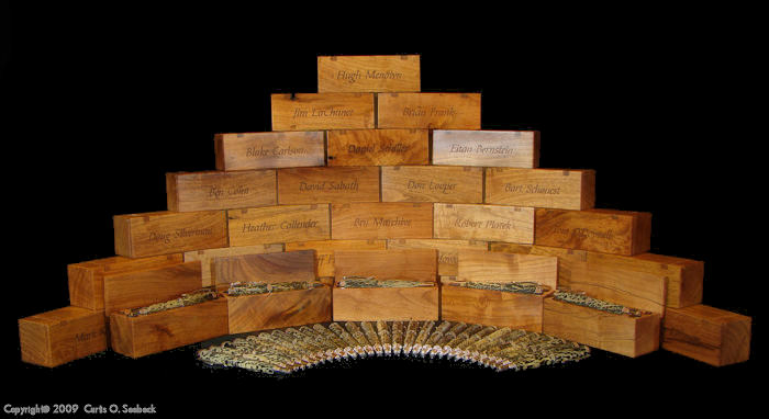

As some know, I was approached by a company in Houston, TX to make 15-18 Jr. Statesmen "Original Cactus Pens"™ with laser engraved Mesquite boxes. Well, I reluctantly accepted the commission (I hate production work!) and the order started to grow. First, they changed it to 20 sets, then 24, then 29, and finally, 33! The due date was short (6 weeks) and I am now COMPLETELY sick of making cactus pens and mesquite boxes! Anyway, I finished packing them all up today and took them to the Fedex office. I sat there and watched as they loaded my box with all my hard labor into the Fedex truck, hoping to God that they don't mess them up on their short 200 mile journey to Houston. They went out overnight for a dinner event tomorrow (Tuesday) evening.
This order was for an energy company who is having a "bond closing" dinner for some of the biggest investment guys in the US. I am hoping that this big order opens some doors into the high end corporate world.
Anyway, here are some pics of the finished order. The pens are all made with my Crystal Clear "Original Cactus Blanks"™ reverse painted black and finished with a CA finish. The kit is the Jr. Statesman platinum with black ti. The boxes are from Texas Mesquite that I salvaged from road construction sites, sawed into lumber on my sawmill, and dried. The box finish is 4 coats of Deft satin lacquer.
Thanks for looking!

I am in awe. Those boxes look great. What are those dark areas where a hinge would normally appear? They add to the looks of the box. Do you have your own laser engraver? If not, you must have had a heck of a time coordinating this event. Kudos to you.

Those are Fantastic!!! I like the lift up box's I guess you got your monies worth out of that plan, I guess it was worth price.

The plan was worth the price just for the concept. I had to completely re-do it, however, since the original plan only allowed for smaller pens and would not hold Jr. Statesman pens. I also modified the lift arms since the original plan made the slot so sloppy that there was no friction so when the lid was opened, the weight of the pen would close the box on its own!
Thanks for the nice comments!
The dark areas are the lift arms that also serve as the hinge. Pretty neat concept, actually. I do not have a laser engraver. My custom cabinet maker has one and did all of the laser work for me.

I think I saw you spelled David wrong on that one box :eek: :biggrin:
Scared me for a minute! Actually, the fault would lie directly on the shoulders of the executive assistant who sent me the list. I simply forwarded it direct to my laser engraver and he did a copy and paste into his software!
