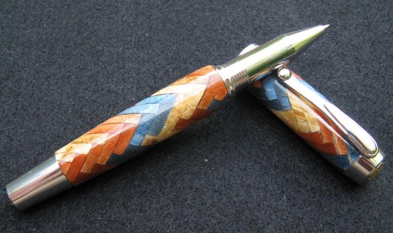

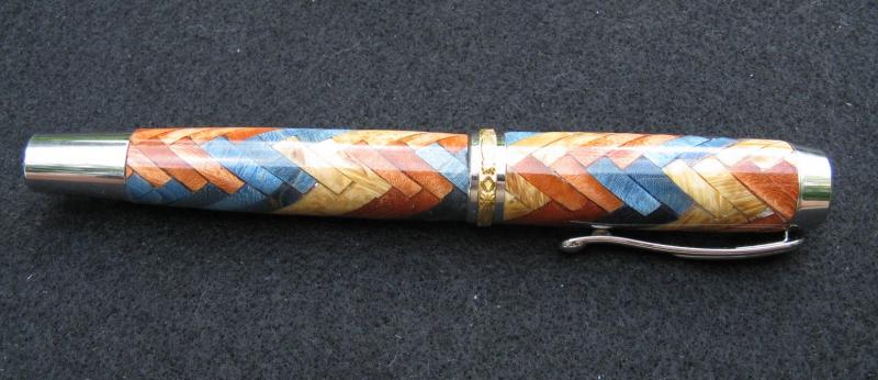

I haven't made a pen just for me in a long time so I decided to take a few minutes and do one. This is a copy of the pen that I sent to my ex-CO in Iraq. It is a platinum Statesman with a stabilized Herringbone 360 in red, clear, and blue. This one was a little nerve racking to drill out, but it was worth it. I put 12 coats of thin CA on it and then micromeshed it to 12000 followed by a slow buffing and the a touch of Renwax. This one is going in my pocket and I think I am going to keep it just for me.

Beautiful pen! that H-bone is so cool looking.

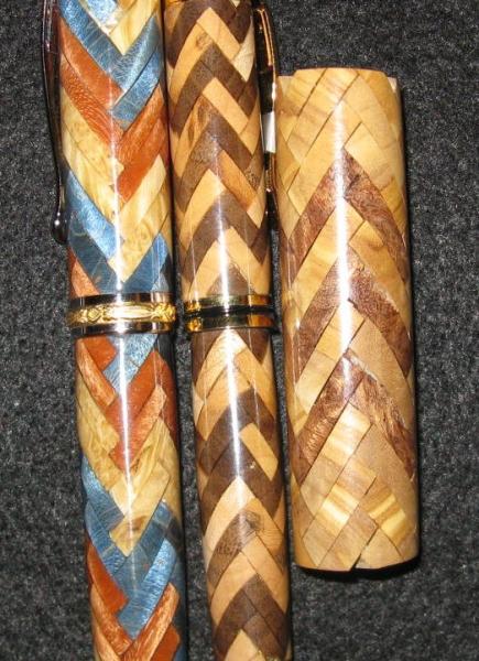

Nice Job Neil! Looks great. I have a Jr. Statesman on it's way for mine, but now you have me worried about drilling it. Why do you say it was nerve racking?
The Jr. Statesman is a lot smaller than a Statesman, you should have no problem with your blank drilling it for a Jr. The attached picture shows the clear difference between a Statesman and a Jr compared to a raw blank. I say, just go for it, if it blows up you know where to send it to get it fixed.
