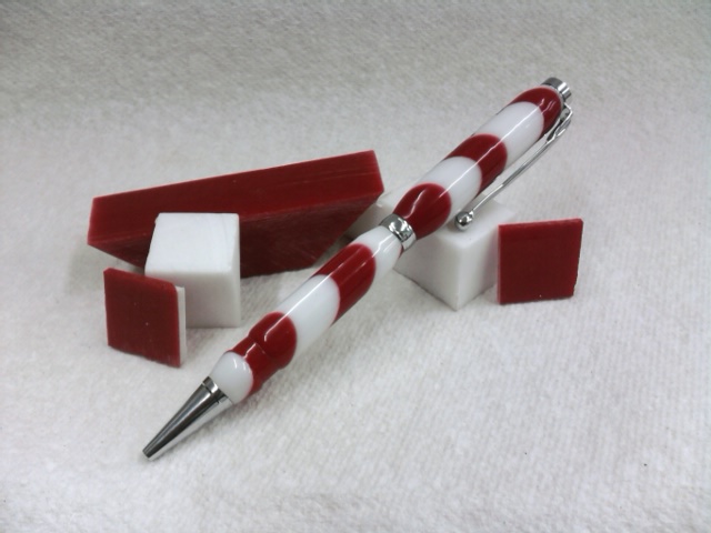

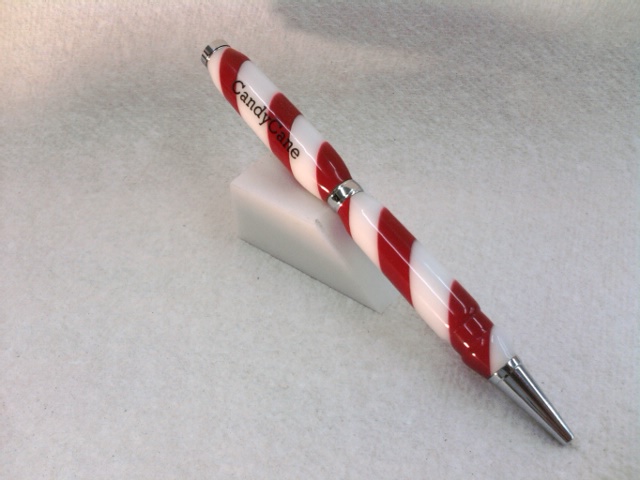

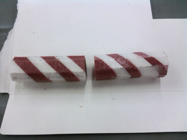

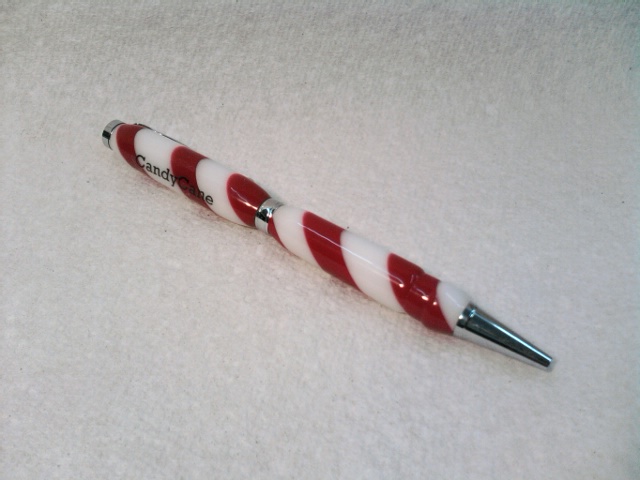

As some of you may know I was looking for a Candycane striped blank a while back for a lady and she backed out of it bacause of the price. I ended up buying some Red and White Acrylic and making one myself. I've got about a half a days work in this thing but it turned out great. I think she will be happy.

That is beautiful Donny, I'm interested in how you glued the segments and would epoxy work on the glue up?
jttheclockman
Feb 22, 2005
19,151
NJ, USA.
Hello Mike. Welcome to the site. Glad to see another segmenter interested. Unfortunately that is a 4 year old thread and the OP has not been on here for over a year. Maybe I can help. It is a bit hard to tell but looks like the pieces were cut on a 60 degree angle to give that better rolling effect. Not sure what glue he used but I always use epoxy when gluing segments. I am a fan of SystemsIII T88 epoxy. If you use CA I suggest med to give you a bit more open time and if putting the whole blank together you may want to even use the thick version. Here is a thread that discusses gluing up and holding angled pieces that maybe of help to you. Lots of info in the segmenting forum. Good luck.
