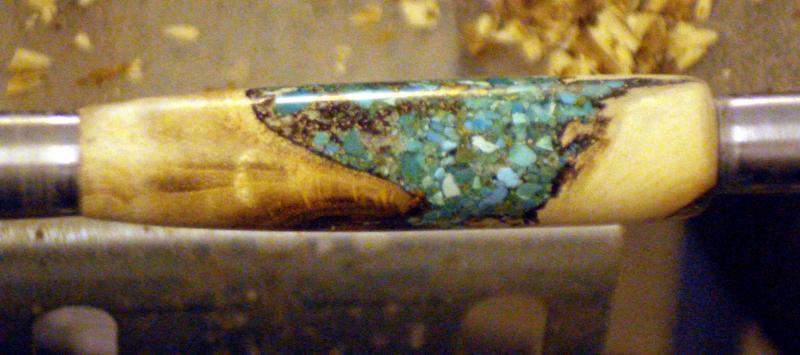

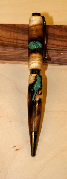

I like to fill voids (cracks, wormholes, knots, etc.) in pens with gemstone. I buy my gemstones in chips that can be up to a quarter inch across. To fill small voids I need very fine chips...even powder to fill small cracks. The best way I have found to crush the stone into fine chips and powder is to cut off the finger of a nitrile glove, put a half teaspoon or so of chips in it and pound on it with a small sledgehammer on an anvil. Works great.
In small cracks I rub the powdered rock into the crack and drip on a little thin CA. For larger voids, I drip in some medium CA, add larger chips, then fill in around the bigger chips with fines and drip on a little thin CA. After I sand the void down if there are any voids in the fill I either add a little of the powdered rock, or just a drop of med. CA to bring it up flush with the surface and resand.
