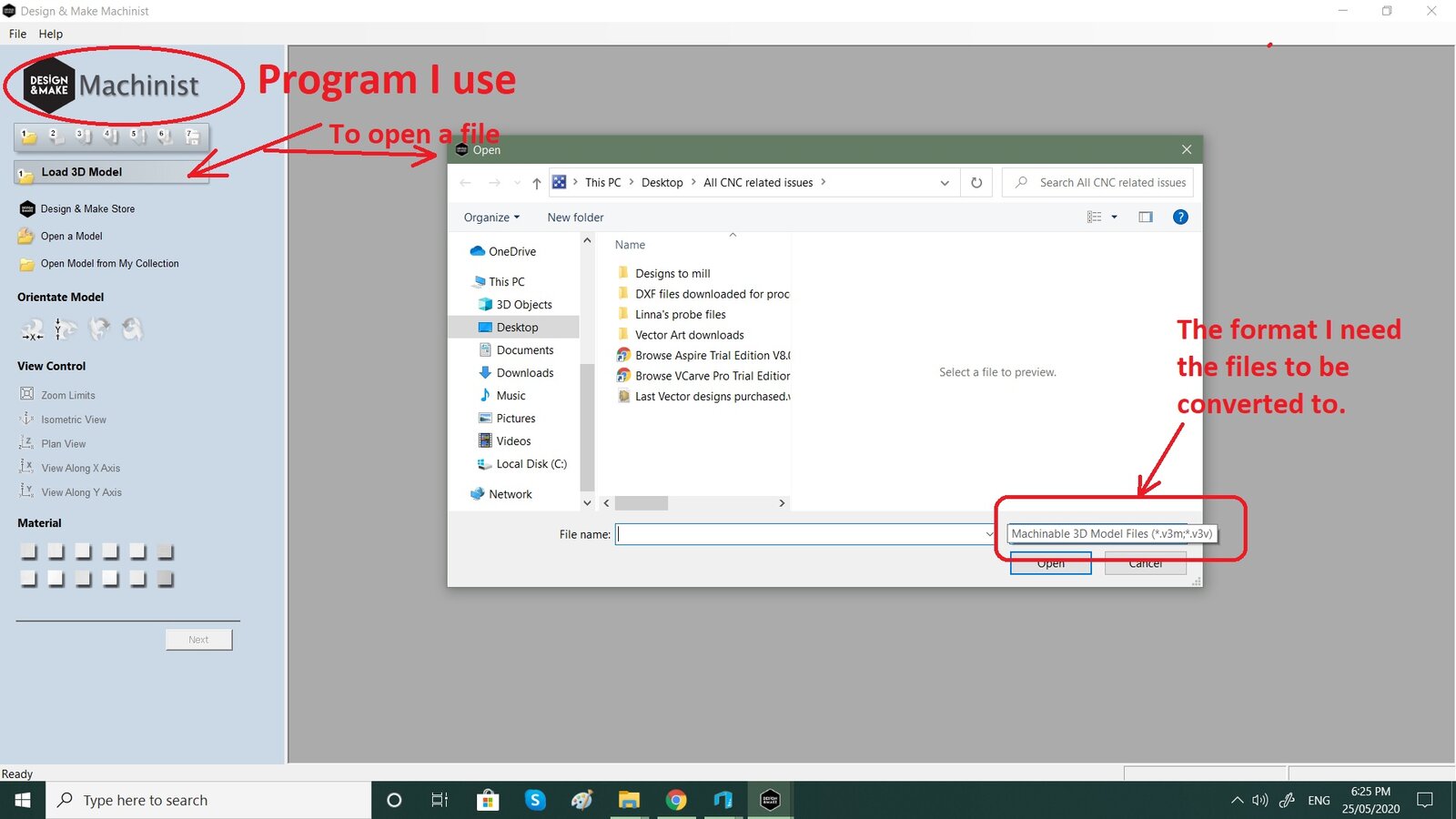

Most of you know that I have a Chinese 60x40 CNC machine I purchased in 2015 (I think...!), I haven't used it in years as I didn't have anything exciting that would want to make me play with it again however recently, I had a request to mill some knife scales out of Red Gum/Colonial Red Gum and I was given a 3D file (STL) that is only suitable for 3D printing as I have already printed both right and left scales, however, I don't have any software to convert STL into v3m or v3v.
I have attached a screen copy of the software I use to download the V3m file and set up the CNC settings for the milling of the part from there I start milling.
Can you help with this...? if you can let me know and I will send you the 2 STL files for conversion.

The program I use to work with the CNC only accepts those 2 formats I showed on my thread attached pic, sorry.
It may be an easy way to convert them but I simply don't know enough about CNC software to know what to do.

So I contacted Vetric about a way to convert an STL into a v3m so that the "Machinist" programs they offer to open the v3m files that we can purchase from them, they tell me that v3m format is proprietary to them so no go.
They didn't mention anything about any of their Software that can open STL files and convert to something else that will allow working with Mac3 and CNC's so I have asked that same question and see what's they say...!
With that said, I'm a bit puzzled as to the what software most people use to design something and then convert into something that will work to create the Gcode necessary for Mac3 to read and make the CNC work.
So I wonder, can an STL file be converted into a format that can be read by some software that will convert it into Gcode for CNC milling...?
Interestingly, I got a free version of 360 Fusion where I can open the STL files I've got but I can't seem to find a way to get it converted into Gcode, I wonder if this "free" version of 360Fusion does only allow to open files for viewing but nothing else...?
Can anyone help...?

Fusion 360 will do what you want, but it is a huge learning curve.
I have VCarve Pro, and I can open stl's directly into it. If you want, send me the file and I will try it in my software.
