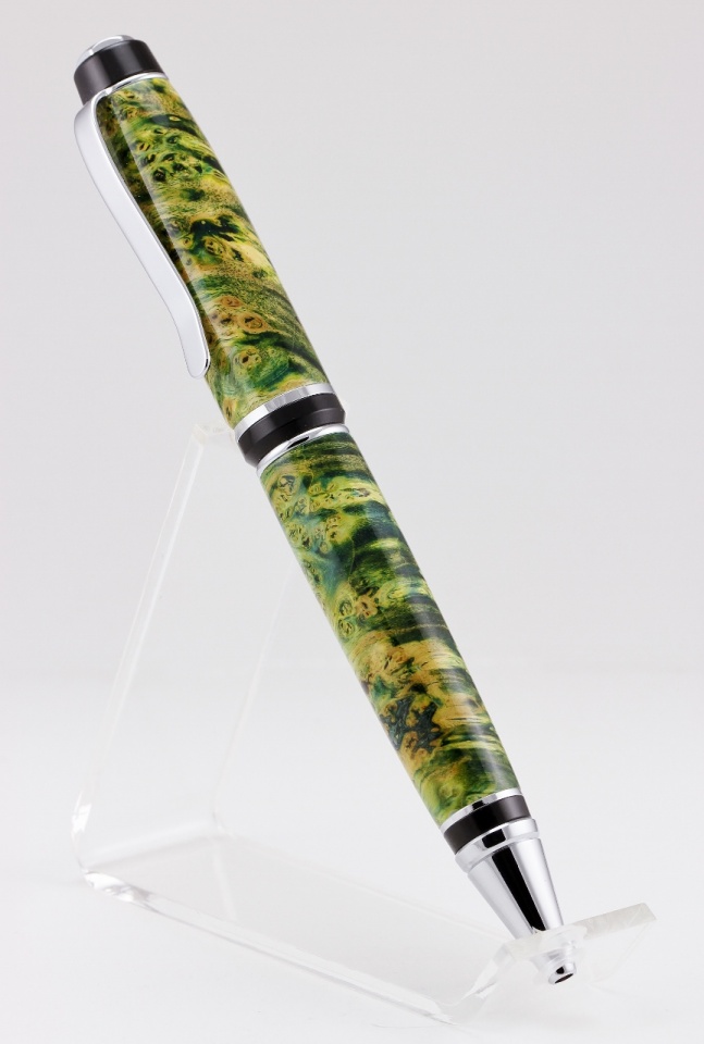

Here is my feedback...
I recently completed 2-3 wood pens over the weekend with the GluBoost products. I have to say I love it. I typically used E-Z bond thin for finishing. I would apply 20 coats of thin to build up a nice shine and deep looking finish. It would take me about 30-60 minutes to do it because I would allow some drying time between coats and since I am applying so many coats there was more sanding and polishing needed at times.
GluBoost is extremely easy. I applied 2 coats of the thicker stuff with the lathe off and then applied 3 coats of thin with the lathe running. It takes like 10 minutes with the accelerator used between coats. Honestly I thought it leveled out pretty well in the coats. So much so that I start with Micromesh on the sanding to get a smooth finish. I just sanded with the top 4 grits of micromesh and then buffed. It really took much less time than my old method. I also used a lot less glue than usually to do a finish.
I liked it so much I sanded down a couple of wood pens I finished earlier (was not happy with) and redid the finish with GluBoost. It was just too easy not to redo those pens. Much nicer finish.
I am not sure what other details are needed. I think that you just need to try it to see what it is like. With a lot of things in pen making there are a lot of ways to accomplish a great pen but it has to be the right way for you.
Here is a pic of what I made. I don't really get a lot of "shine lines" or glare on my pens when I photograph them. My light box filters direct light very well. Believe me when I say that the shine is excellent on this one.
