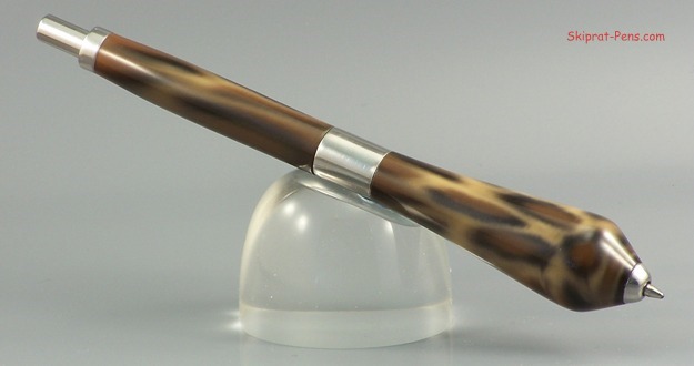

I made this one for my late Mom. It's based on a standard two barrel click pen. No reason why you can't just use a Long Clicker and turn the end as wide as you need.
Craft Supplies UK used to carry one called a Jumbo Pen but they were taken over by Turners Retreat here in the UK, and I can't see it on their site.
I'm sure the recipient will be more pleased by the functionality than the asthetics (sp?) so a blank that doesn't 'flow' from the nib shouldn't be a problem.
Good luck
Oh BTW....my Mom asked for a clicker as it was difficult to twist a pen
