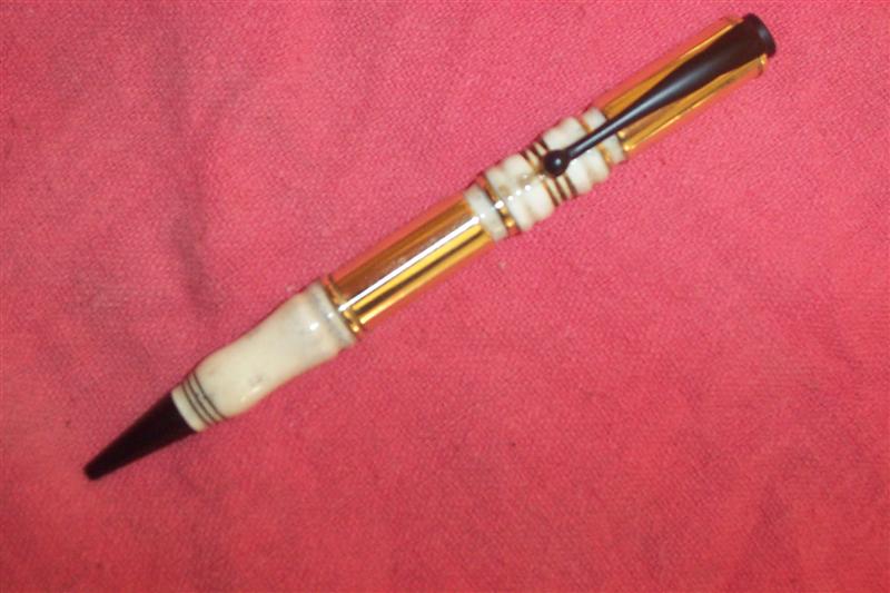

Ed, I did a .45 ACP Cigar and Antler. I think it turned out quite well. I've also used 9mm on an 8mm Euro and the brass fit just about perfectly. I paired it with bamboo and it was a little plain, but one of my regulars bought it for her brother who is a police officer.
Once you get the brass, start comparing it to various parts from various kits. You'll find one that matches pretty close and you can then use just about any of the methods that many have posted to get the end result.

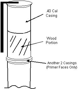

We use .40 cal pistol ammo which is actually a decent size for a pen barrel (Diameter I mean). I would likely do one of a couble things. Either use the casing as the finial end of the pen with a base kit of a Slimline, Euro or if you wanted a Parker than a Perfect Kit or Elegant American. If his dept uses a rifle as well, then you might do a rifle casing and the pistol. My dept uses the AR-15 in our cars which is a .223. Not good for pens at all. But we also have 300 Winchester Magnums that are used by our SWAT team snipers.
Here is a quick sketch of what I might do:
The joint where the two primer faces come together would be smiliar to this one, but picture the lower body of this pen as a wooden body with only primer faces contacting in the middle (Centerband):
Hope that helps to get some creative juices flowing.

Ed, here is the cigar I was talking about. This should give you some ideas.
<b>Image Insert:</b><br />
<br />
I turned tenons on the antler so that it just fit into the casing on either end. I chucked the CB in my Beall and turned it down to fit giving the illusion of yet another piece of casing.

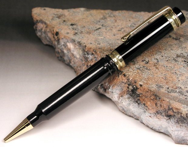

Here's one I did a long time ago.
If you need pictures ask Lou, I gave it to him.
(I'll bet he'll think twice about saying he likes something I make)

IIRC I made that one in a longwood design.I believe it separates between the brass and the antler just above the nib.
That is how I would make now.

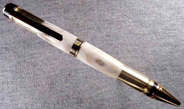

Here is one of the first ones I did using a 45 auto cartridge.
http://tinyurl.com/empkz
Here are some others done by my good friend, Jay Pickens.
http://tinyurl.com/pmydc
Hope these ideas give you some ideas. Show us the finished pen.
