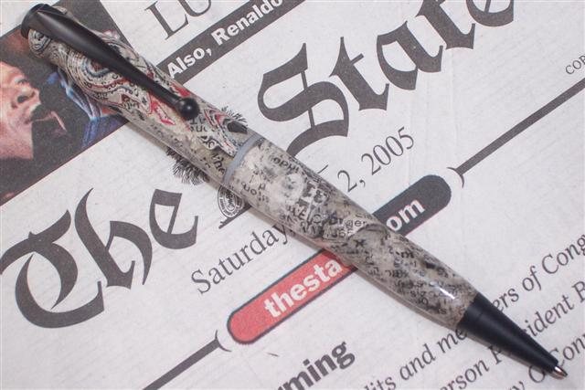

Great looking and interesting pen. Wonder how it would look with a red CB to enchance the red that is already there. Might not do anything for the pen and might distract too, but just curious. Or maybe a dark gray or black CB.

Often I don't put CB's on my pens.What I used here was a nylon spacer so I didn't glue both blanks together.This pen was don't in whimsy to see if an idea worked.It did and it will probably not stay in this configuration.It was basically a test.
To others.
Yes CA glue is used the same as in my denim pens.Sine there is a layer of Ca between each "layer" of paper and the paper is wound larger than the bushings,I am turning off a stabilized paper, not just an out coating.
It doesn't take as much glue as you maight think.
It doesn't take much imagination either.[:D]

Originally posted by GregD
<br />Eagle,
What did you use for the center band? That's not plastic from a pop bottle is it?
Actually that pen was a time killer while while working on other things.
It will probably be dismanlted and /or remade.
The CB in that pen is a piece of the stuff they use for bread boards.(HDLW or something like that.)I use it when I am going to use CA for a finish so I don't "stick" the halves together.Normally I use wax paper but in this case I wanted a little more"protection"
