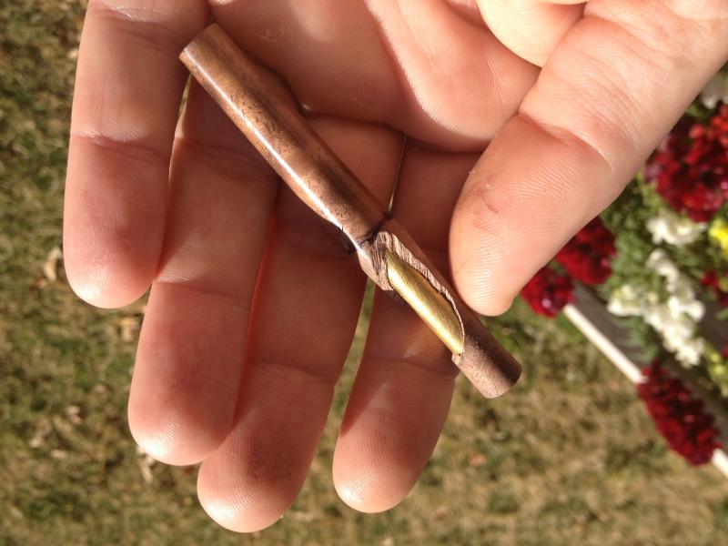

Hello,
I'm new to wood turning and have finished 3 or 4 kits so far. I have already had 3 blanks 'explode' on me on the lathe. The first, a piece of figured walnut, second one was a piece of cocobolo, and another piece of walnut again this evening. This is getting frustrating!
The first two were assembled with CA, and it looked like part of the problem at least was due to incomplete glue coverage. I switched to epoxy on my latest ones, thinking it would solve that problem, but it doesn't seem to have. I am applying plenty of excess glue, it is oozing out as I spin it slowly to insert it.
Is there a trick to getting complete glue contact? Is this part/all of the problem, or is it something else that I'm doing wrong?
Thanks!
Here is a photo of the first one (walnut/CA)...I will try to take a shot of the epoxied one to post tomorrow.

Cross cut or angle cut blanks are always prone to the type of failure you have experienced because the wood has lower shear strength parallel to the grain than across it . Make sure your tool of choice is super sharp and take very thin cuts . On porous woods it sometimes helps to apply thin CA and then turn it down . Several iterations of the process may be required .

From the photo there is no glue on the blank or tube. I highly suggest using epoxy. I use System 3 epoxy and never had a failure. Also the tube does not look roughed up. Yes you need sharp tools but that blank should be no harder than any other to turn. I like to use a skew.

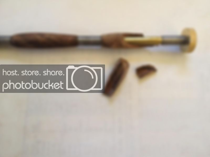

OK, thanks for all of the feedback so far. A few comments:
1) The first 2 were glued with CA, the third was with epoxy...same issues and result. In all cases, excess glue was added, the tube spun slowly during insertion, and excess glue came out of the hole.
2) These were drilled on an inexpensive Craftsman table-top drill press, which is all I have to work with and probably part of the problem.
3) A brand new (or nearly so) 7mm pen making drill bit was used for all holes.
4) I did put CA inside the hole as well prior to inserting CA covered tube, but did not put epoxy inside first when using epoxy.
5) I am using a new'ish Easy Wood Tools carbide cutter for all turning.
6) The first one (or two), I was probably trying to cut too aggressively. I was going very slowly and carefully on this one.
I will be sending some wood off for stabilization soon, but prefer 'natural' wood when I can get away with it. Oddly (to me at least), the walnut was much harder to cut than the desert ironwood blank I turned afterwards.
Thanks again for the input! Here is a photo of the latest blowout (walnut w/ epoxy):

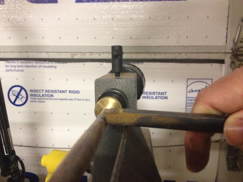

I think you are saying that the centerline of the lathe is at or slightly below the top of the tool rest , and that the tool rest cannot be adjusted downwards . If so , I would hack about 1/2 inch off the tool rest post . The rest needs to be low enough to allow the tool/wood contact point to be close to or a bit above the lathe centerline , not below it .
If your lathe is too low relative to your height , you may be unconsciously dipping the tool downward . Angling up is best , for me , essential . I totally agree with Mike about using the carbide tool as a shear . The only time I use it as a scraper is to attain a precise final diameter at the blank ends .

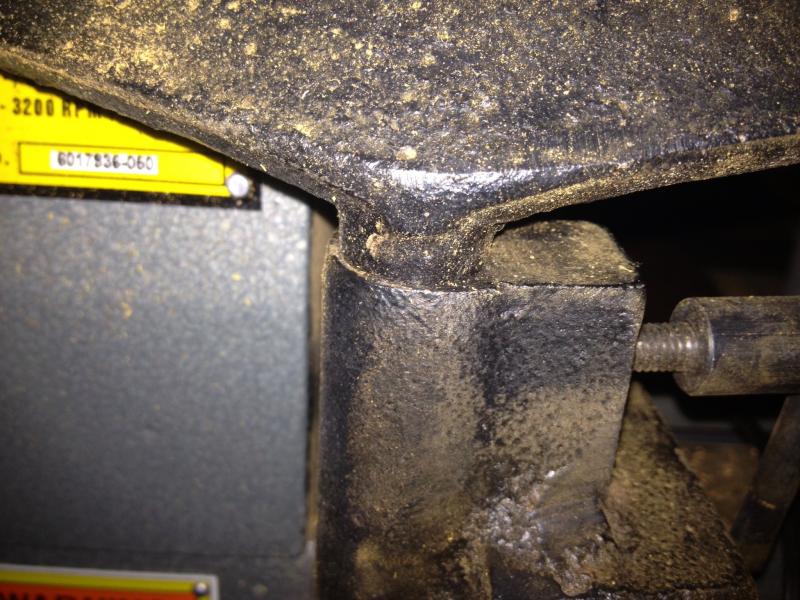

I think the height of the machine is ok, it's the tool rest that is a problem. Due to the design I'm unable to trim the post to have it sit lower. Hopefully these photos show what I mean.

Can I suggest you take a photo with your tool rest as low as it can go and have a pen tube, not a blank just a plain pen tube chucked up. Now take a photo from the side so that it shows the rest in relation to the center of the tube. I can not believe you can not get the rest low enough to use the carbide tool. If you want you can measure the top of the rest and then the center of the tube from the lathe plathform. This will give us an idea of how much difference you are talking about.
If all else fails, why don't you just switch to using a skew??? You will do a whole lot better if you can learn to use a skew. It will give you better finish results than any carbide. I know I sound like a broken record already when people ask about tools. But there honestly is no better tool suited for what we do than a skew. I do use a carbide tool but only for blanks that I have metal segments that are larger than thin flashing. I do this only because it saves on sharpening time. This again is just my opinion:)
One other thing, as far as the proper lathe height goes, it should be low enough so that your elbow at a 90 degree angle can operate a tool to the center of the head and tailstock.

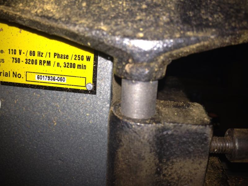

Here you go, I think you can see how high the tool is positioned (worse than I even thought). I guess that's the cost of cheap tools.
I have no idea how to use a skew but I guess I could get one and learn. I walked into the local woodcraft a while back and they recommended the carbide tool for me as a beginner.

Is that your carbide tool and is that the way you present it to the blank??? Something just is not adding up. If that is the tool rest that came with the lathe it is too big to begin with. Did you replace the tool rest???

There's the problem, looks like the bottomed out tool rest is at the arbor centerline. Like others have said the carbide tool cutting edge needs to be presented flat (parallel to the floor, or slightly handle end down, and at the center height of the blank). your tool rest needs to be much lower, have you verified that the assembly is correct or looked at photos or the store demo model? I have blown up blanks with the carbide when the handle end is raised and it gets drawn under the rotating blank, with that setup it looks like you have no choice but to raise the handle and turn from the top.

No way that is going to work on a consistant basis. If you want to keep the lathe, change your tool post. Rherrell or Johnnycnc can fix that easily.

As others have said that is way too high. You want to be able to adjust that down so the tool is at or near center or even a bit below on your work. But you don't have to stop turning until you get a new tool rest! If you have a skew you can take this opportunity to give it a try. Your tool rest goes low enough for a skew from what I am seeing. Another thing that I would definitely do with that tool rest is to file/sand or otherwise smooth that surface. You really don't want any bumps dimples or other roughness on your tool rest. I use my stationary belt sander on mine and smoothed it up. I know it seem picky but it will make your turning so much more pleasurable you won't believe it. Now chances are that you could in fact grind that tool rest down but I am not suggesting that you do that but it could be done. I have drooled over those tool rests that are in the link in another post and the price isn't bad at all!

If you have a grinder you can remove the tool rest base from the lathe and grind off the top a little to allow the tool rest to go lower. Plus it will save money on buying anything to replace it. You should definitely have some room for movement up and down as not all tools are the same height when presented to the work piece.
