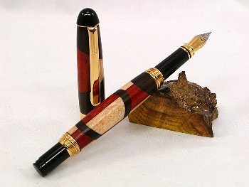

I recommend you invest in a 2 horsepower, 8-12 gallon air compressor, and purchase a good quality spray gun to go with it (I have a $450 gun [:0], but a $75-90 Eclipse Gun or something equivalent will work well). I've found that two coats spraying lacquer with a gun at 40 PSI, with the sponge sand between coats, gives a beautiful, glossy appearance. The pic below was taken of a checkerboard with only lacquer - and I was using a satin - not a glossy lacquer. I should have put a third coat on because there are imperfections - I rushed the job - but the results were still ok.
