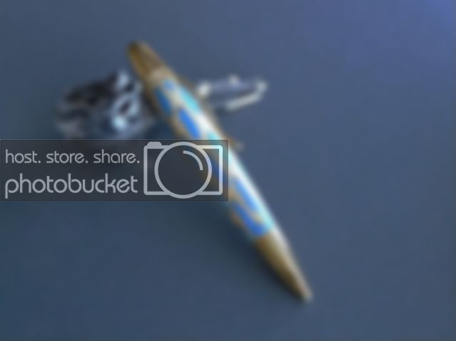

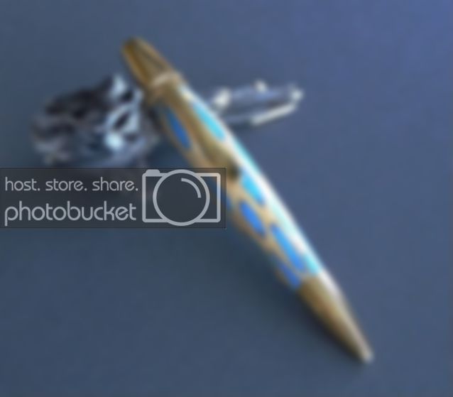

I used blue sand to fill in the cactus- looks kind of like turquoise- on a polaris. I've had this one for awhile and it is holding up well. Cactus is just what you would expect someone from the southwest to have in their pocket.:biggrin:
If the sand is really fine it is not too hard on the tools- course sand is instant dullness. I turn the blank down to almost finished size- then fill the voids and soak the sand with CA.
Reptile tank sand?
I got the sand at hobby lobby- it comes in different colors and it was 99 cents for a large container. Picked up black, blue and red- the blue had the finest sand of the three and was the easiest to work with.
