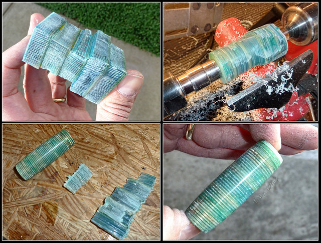

Okay, so I've been known to try different things from time to time and today I found myself cleaning out the garage and came across some old home burned CD's from like the late 90's I'm guessing. Couldn't have been too important sitting at the bottom of a box so I figured...why not :rolleyes: Glued a couple of them up, cut on a bandsaw, glued those up, drilled and turned. Since this was for fun and kind of like a test I didn't paint the tube or the inside of the blank and figured...lets see what happens and this was the result. Almost a pen so I'm told I can show it :biggrin:
Don't forget...it's not serious until you make it serious...have fun and turn what ever you can find. Who cares if things line up or look pretty...just have FUN :biggrin:
Looks cool
What kid of glue did you use on this?

Medium CA. It's what was close when I started cutting so I ran with it. Again...just a test, I'm sure people could advance the idea and do something much cooler. It does have a nice vintage look though

What you're seeing are tool marks from the blade on the band saw. The Eagle trick would be reserved for a highly prized segment pen. This was a quick 15 minute pen :)

They do crack easy, but a CA fill on the final turn should fill cracks and smooth everything out while having a cool looking material that you've turned. Painting the tube or the inside of the blank could add a different effect as well.

You were more successful than I was! I still have tons of little pieces from when I attempted this. I hit it with the gouge and the whole thing literally blew up. Reminds me why I wear eye protection, always :biggrin: Glad you made it work though, I was very curious on what it would look like.
