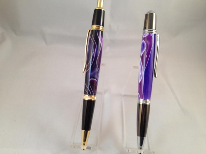

I wouldn't paint a dark blank with a dark color - unless you're really looking to darken the finished pen.
I've got an example at home that I'll post later. It's a 2-tone purple blank. I made 2 pens, one painted black and the other white - dramatic difference between the two.

Here's the two pens I mentioned...this is the "purple rain" blank from Woodcraft: http://www.woodcraft.com/Product/2020297/21363/Acrylic-Pen-Blank--Purple-Rain.aspx
reverse painted black on the left and white on the right. I did these as an example of what reverse painting can do for a class I was in a few weeks ago.
Thanks Penguin. Very noticable difference.
