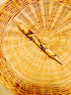

I decided to bite the bullet and try to make the pen my son wanted..
I was intimidated by the tenon! The cap turned out well. The bottom has a step.
I used the bushing as a guide but I still managed to leave a small step and a very small gap.
I will need one of those trimmer things to insure a better gap-less fit.
More money for the Vortex :)
My 90 degree sander let me down.
Over All I am pleased with my first Attempt at this style pen
Thanks for the encouragement Y'all
Spalted Hickory (I found on the side of the road)
