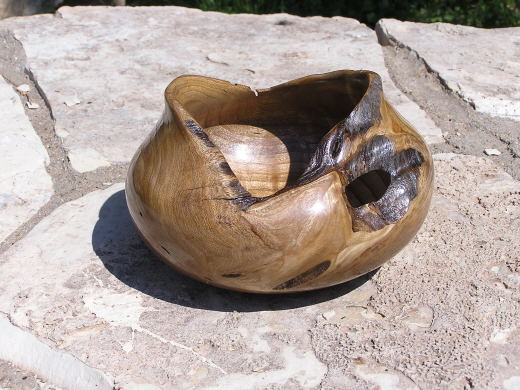

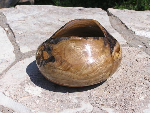

The Eucalyptus that I've turned was grown right here in Northwestern Texas. It is beautiful wood, has great grain, and has even made some beautiful pens. Just depends on how you slice it..... :eek:)
I finished a hollowform from some of it today, and will buff it out tomorrow. Don't have time for phototent pics, but could snap a quick shot on the bridge, if you want to see it...
Here it is: 8"D x 5"H x 3/8"T

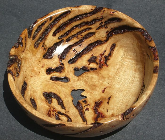

Just be careful, eucalyptus is one of those things that many people are allergic to. My friend was hospitalized from sanding down a eucalyptus walking stick. He didn't know he was allergic to it until this throat started closing up and his tongue started swelling.
If you aren't allergic (or have a good filter) then eucalyptus can be absolutely stunning!
Tazmanian Eucalyptus Burl bowl
Greg, that is a gorgeous piece of Euc! I have a small piece, about pen sized, with those inclusions in it. It looks like it was cut from your piece of wood. I think it's some kind of resin in the inclusions... wish I could remember what it's called....
I didn't have any ill effects from the piece I just turned... and I love to smell it while I'm turning.

The stuff in the voids in mine was wax. The whole thing had been dipped in wax to keep it from drying out too fast. Dental picks worked great for picking it all out.
