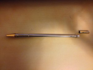

The slimline pencils I have done have the eraser under the clicker shell. Pull the plated clicker off to expose the eraser.

So ... If I understand right the eraser is there just under the push button? I'm speaking of he CSUSA artisan slim
Yep, but as previously said, its pretty small and I doubt it would work well for an elementary student.
