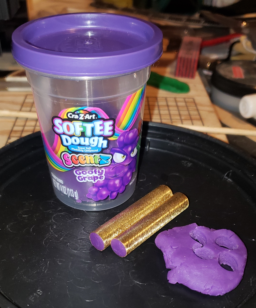

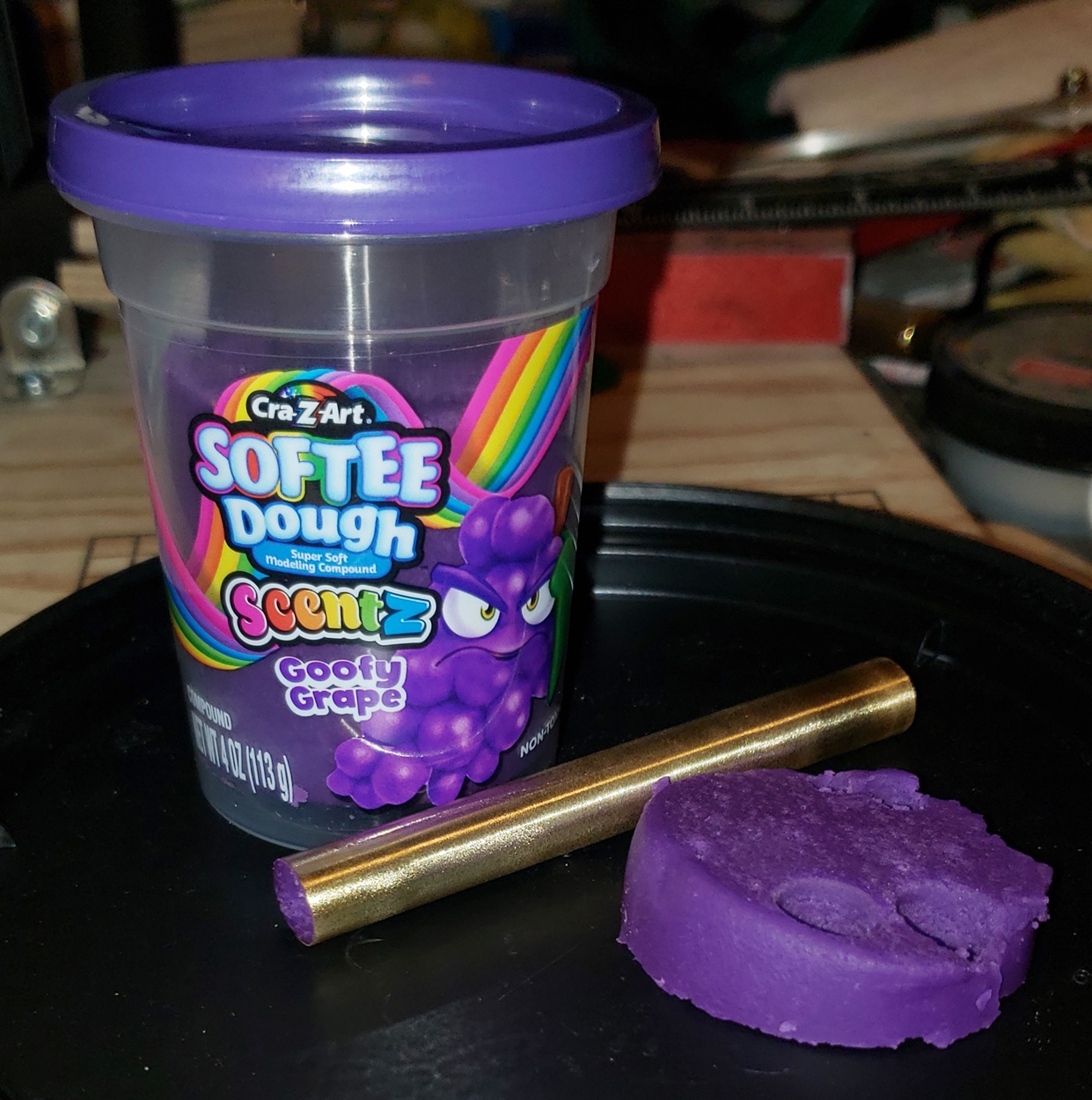

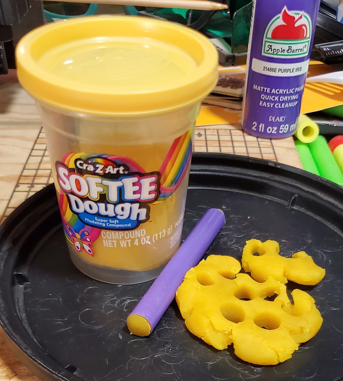

Playdough, plasticine, bluetack, whitetail, Rodico (Swiss greentack) (I mend watches so have loads of that stuff.). Or a Wax of some sort.
Quite new to pen turning so doing a lot of research on the university of YouTube so seen lots of different options being used.

Pulled this up as I was wanting to keep the inside of the tubes clean. I thought of melting a candle on wax paper and using the wax layer in the tube.
