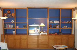

Here's a 14-foot long Entertainment Center / book shelves that I made a while ago. It has an opening for a large flat screen TV that I hope to fill someday.

Beautiful! I like the clean look attained by not using pull knobs or handles.

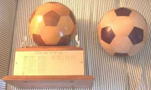

The entertainment center looks great. The wooden soccer balls, awesome! Did you make those. I'd love to see some close ups of them.

That is sweet. A lot of man hours in that project.
I saved a lot of time and money by using unfinished kitchen base cabinets from lowes/home depot. I chopped off the bottom 4" kick board section, sanded the cabinets, stained and then applied a few coats of poly. I bought unfinished trim and again sanded, stained and a few coats of poly. The cabinet top and the shelves are made from oak plywood. Thanks for the kind words.
