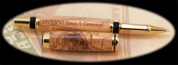

Originally posted by emtmike
<br />Ok So what kind of outcomes have you all seen with laser engraving BOW
Beautiful. Example below.
<br />
laserturner
Feb 6, 2004
158
Las Vegas, Nv., USA.

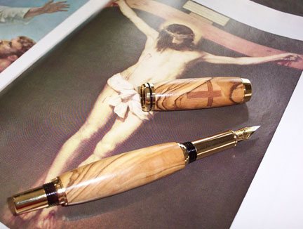

There's a solution that you can brush onto metal which embeds a black dye on the metal when laser engraved however its not 100% foolproof. Here's a link to a new Epilog machine which does engrave on metal. http://www.epiloglaser.com/fibermark_laser.htm Cost is about 30K. Unfortunately, it doesn't engrave on wood. Also, here's a BOW I did awhile back for William C. It engraves really well if you can find an area with light figure.
<br />
