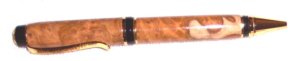

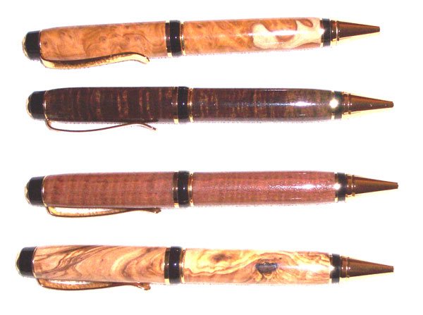

Then I started reading about the Enduro Water Base Poly. I bought a sample kit of a quart of high gloss poly and a quart of their sanding sealer to match. Attached to this you see the result, the first four pens I finished with that product.
Here is my method and it still needs a little more refinement on my behalf but it works and gives an outstanding finish.
