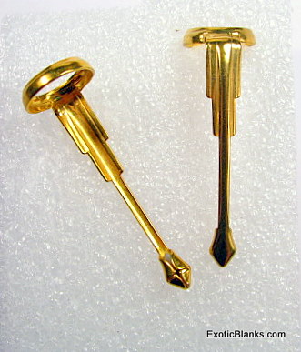

How does one secure this clip to a pen? I can not find any pictures.

Looking at how it tapers on the inside, I would say that you would turn the top of cap to match that taper. The clip would fit down over the tapered cap, then the finial would either thread into the cap or a tenon on the finial would be glued into the cap. Either way, the clip ring is sandwiched between the finial and the cap.

Dang Chinese secrets. I thought maybe I had to epoxy it, but was hoping there was another way. I will try gwilki's approach and if not successful use epoxy. Thanks for your responses, I can always depend on someone here to set me straight.
