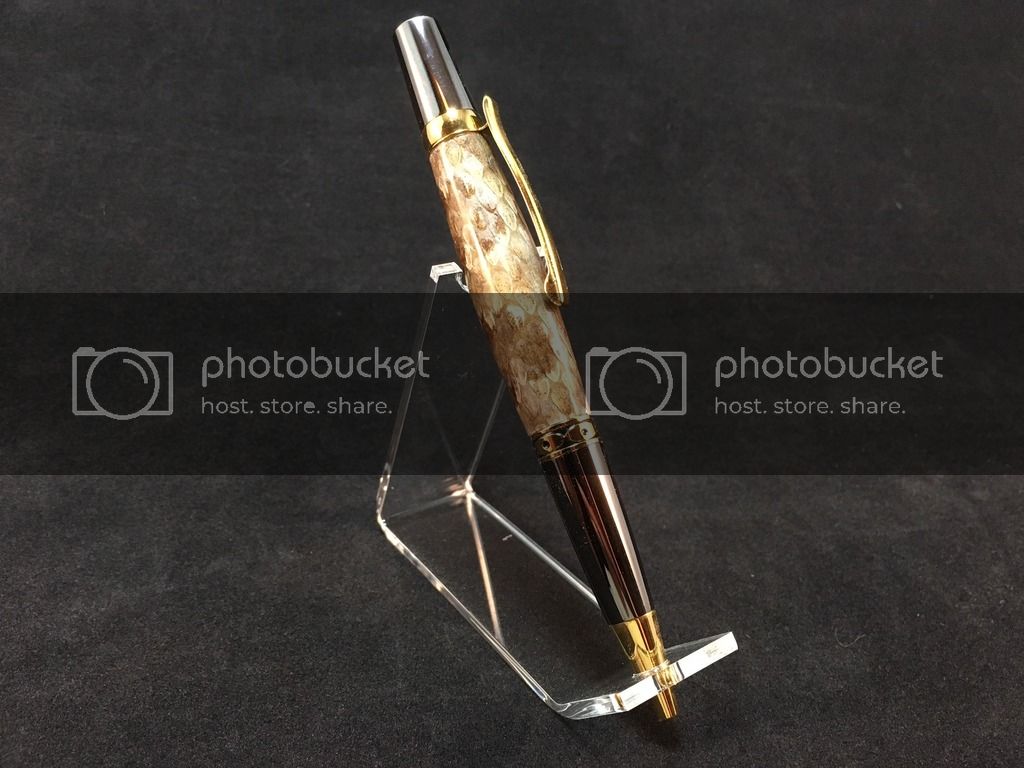

Received your newsletter today and it looks like you've got a winner with this new component set.
A few questions:
Is the blank size the same as the Sierra?
Does the one stylus match both finishes?
Will you have a "Vista" size for this component set?

Hi Larry,
Thanks for asking!! I have a lot of time and effort in this particular design, so I expect to use it wherever I can!! Yes, the bushings for the sierra and dozens of other pens will also work for this one.
So FAR, I only have the stylus in gunmetal, every design prior to the new TiGold-Blkti has had a gunmetal upper. I wanted to introduce and troubleshoot as few platings as possible. NOW, if this takes off the way I believe it should, I will be doing several plating combinations and we will have to have more stylus platings available.
Thanks for asking!!!
