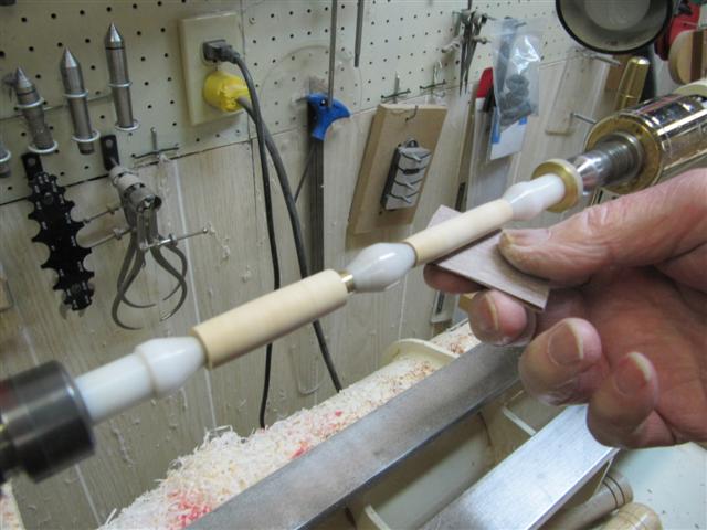

This is the only time I ever use a mandrel!
attachment.php
I have 2 sets. When the first set gets encrusted with CA (and it will), while it's sitting in Acetone, the 2nd set gets used!
Mack I'm confused, how do you turn down the blank to the correct size ie 7mm for a slimline pen with these bushings when they are cone shaped and is that a metal bushing i see next to the delrin one in the middle between the blanks? What's it for? Sorry for being so ignorant but I'm brand new to turning
Hi Garry; Not a bushing! That style of pen requires a tenon to be turned on the upper blank. What you are looking at is the tube of the pen protruding.
What's it for?
The tube is protruding to allow the centre band to be pressed on it.
Gerry, there is ignorance, and there is ignorance. One comes from not knowing, the other comes from rudeness! Yours came from not knowing. That's why we come here; to become unignorant!:laugh::smile-big:if in fact there is such a word! I'm more than happy to help.
