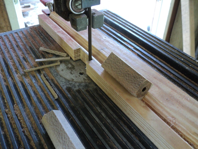

Simple jig I use...
Attached is a photo of a simple jig that I clamp to my bandsaw table to shave off the corners, to basically speed up the turning process..I used
my router & cut a "V" grove the length of a scrap piece of 1 x 4 & cut out a gap to move the blade close to the groove...picture is self explanatory..
My only problem with your jib is that, you have to grab the blank with your fingers to push it to the blade, for a full pass, and that is exact where the "danger" is, the motion and proximity of the hand and blade aren't something that I would advise, particularly for those LESS experienced with a bandsaw or for those with TOO much self confidence (deadly combination, sometimes...!:frown:
You have to remember that, a lot of people will follow advise given and imitate what they see, this is only normal and that's when we all have to be very careful in what we advise other to do or show something that we use but that has a great degree of risk/danger and while most bandsaw blade CATCHES/GRABS are preventable, some are NOT and with fingers that close to a running saw blade, you have absolutely to chances to avoid a incident so, now that you've got you piece of wood grooved for the blank, make yourself a favour and make one of these, they were made to precisely address the danger I just described...!
Please, don't be offended by my observations, I can not turn my head the other way when I see something that is dangerous, and that can be easily avoided, this is "precautionary" criticism, I've been using all types and sizes of bandsaws for about 4 generations, I have had my close calls, incidents and accidents (very different things), sometimes is just not worth the risk, believe me...!
