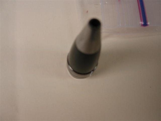

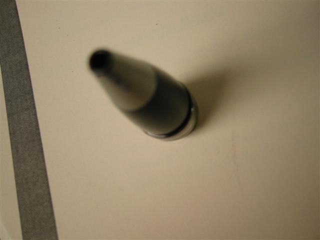

I'm trying to put together an El Grande ball point pen and I'm running into a problem. After I push the nib into the black nib adapter, then you're supposed to push those two parts into the nib holder. Well on the two kits I have, this step just won't push together. (Don't tell anyone, but I even tried using a hammer to get them together. It's just too tight of a fit. When it did this on the first one, I thought maybe it was just a defective kit, but the second one was even less willing to go together. And it looks like even if/when I get them together, the nib holder is going to be slightly wider than the nib adapter piece. Anyone else have this problem? Anyone have any ideas of how to solve it?

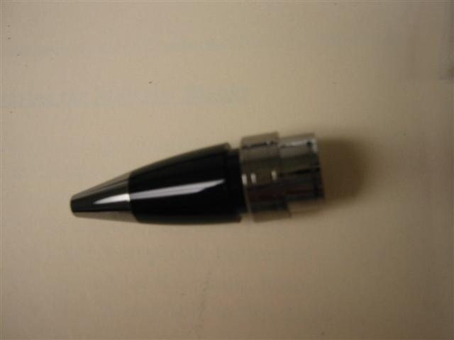

Here's a picture of a completed one - the diameter does vary from the nib holder to the nib adapter.
http://www.omanopa.com/Pen131.jpg

Well I think mine really doesn't seem different from what Tony's describing. I tried to take a few pix of the two that are partly together. It looks like I'm going to have that same difference like Tony shows in his. But next time I think I'll try Randy's idea and use some sandpaper! At this point they're both partly pushed in, so I have to decide if I'd be better off using more pressure, or taking it apart and using sandpaper before trying to push them together again. I'm not sure why the manufacturer made them this way!

from the photographs, and from doing rollerball and fountain pens the TI part looks like the receiver holder, not the nib holder, not sure if the ballpoint kits are that much different.
