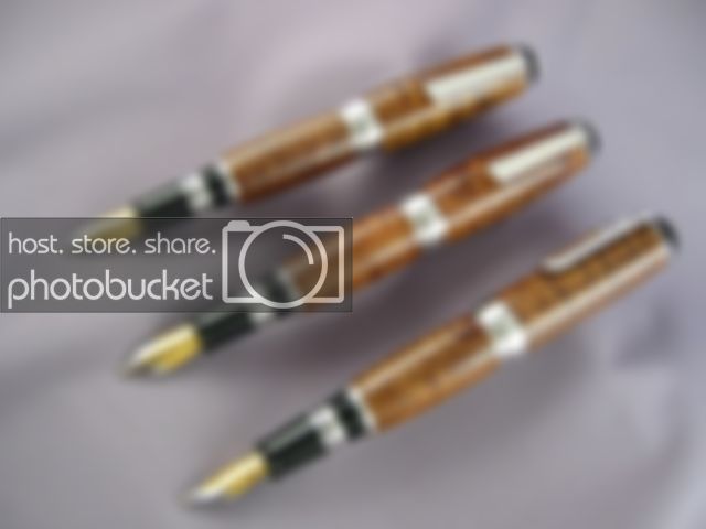

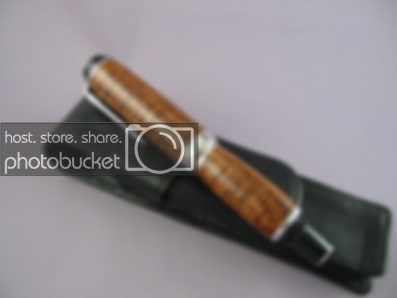

Hi,
These are a few pens I turned today, trying to keep busy and my mind of my hip and heart problems...pen turning can make me very calm.
These are some curly koa blanks I bought on Ebay years ago I forgot al about till recently.
Turned with a skew, no sanding. Four coats of spray lacquer, wet sanded with MM 6000-8000-12000 and plastic polish, wax.
An interesting pen, we'll see if I go for more.
Critiques please

Jim, Awesome pens! Love the figure on those koa. My skew skills cannot compete with sandpaper yet and probably never. How do you like the kit? I've been meaning to try it but never did.
For critique...what are the white dots on the cap section of the 2nd pic and the lowest one on the 1st pic?

Great looking pens Jim. No sanding? Wow, I think you can replace Alan Lacer as the king of the skew. Other than what Dario said, I don't see anything to critique.

Thanks Dario and Gerry,
I saw that, it's got to be the wax, man that is frustrating...I went out just now and looked again, I am going to see if I can seal it with dark furniture wax..
Any ideas....?

The kit assembles easily, no surprises, same as the Havana as I see it. The mini look takes awhile to adjust too...no room for a long cartridge or pump....I might try making a solid end one.
