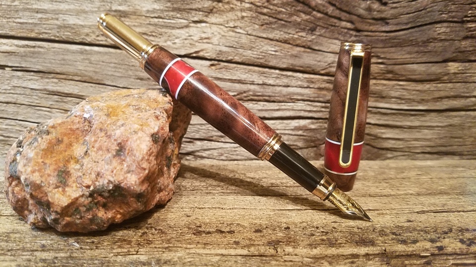

Or do a segmented pen, use cutoffs on each end, with something inbetween like aluminium or copper, or a piece of credit card. So it would go like this [ |___| ].
Or like the pen pictured.
