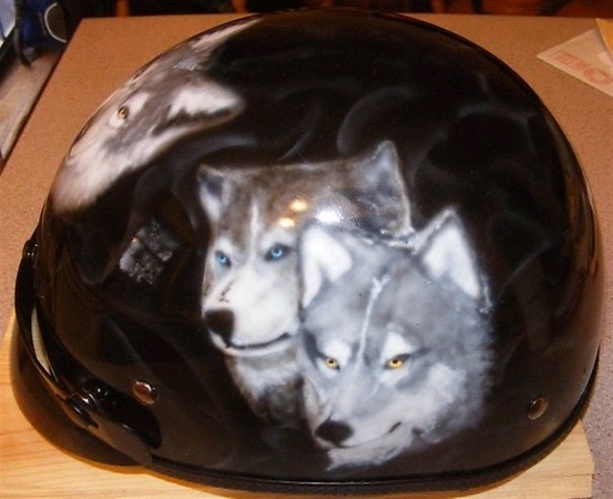

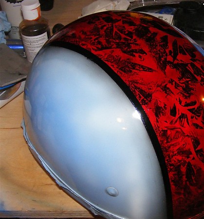

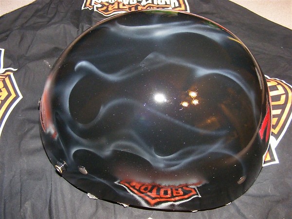

I do agree with you on the use of ebonite. I'm not suggesting putting a finish on the swirled types of ebonite either. If I put lacquer to ebonite it's on plain black. Plain black ebonite is more versatile for finishes and is cheaper also then the swirled cumberland type rods. Using black ebonite and lacquer to me is commerating the vintage urushi type pens. While I can't get urushi stateside there are techniques I can do the emulate SOME of the urushi techniques like maki-e and shibo urushi and the tactile type finishes which I was shooting for before I grabbed the urethane.
The only finishes I apply are to wood, ebonite and motorcyle helmets like below. Urethane produces great effects on non rubber parts :) Lacquer and urethane both melt into each other and translucents give neat effects.
