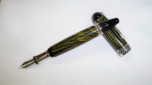

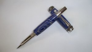

I didn't find the PSI blanks to be that bad, maybe I got lucky. Here's what I was able to come up with:
Apollo Elitte II with Green/Yellow Ebonite (Sold 10/9/10)
Majestic Jr. in Blue/Beige Ebonite.
Any thoughts are appreciated!
