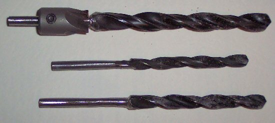

I solved that problem by going to the "Buck" store and buying a set of metric drills for a buck and ground down the shafts , on my grinder , to fit the barrel trimmer . A 6mm bit for a 7mm tube , a 7mm for an 8mm tube and a 9mm for a 10mm tube . Only takes a second to switch when you want to . See the pic below . They might not LOOK pretty but they DO work !!

Originally posted by dougle40
<br />I solved that problem by going to the "Buck" store and buying a set of metric drills for a buck and ground down the shafts , on my grinder , to fit the barrel trimmer . A 6mm bit for a 7mm tube , a 7mm for an 8mm tube and a 9mm for a 10mm tube . Only takes a second to switch when you want to . See the pic below . They might not LOOK pretty but they DO work !!
<br />
My pen mill came with shafts for 7mm, 8mm, 3/8" and 10mm so I only needed adapters for the bigger pens.
