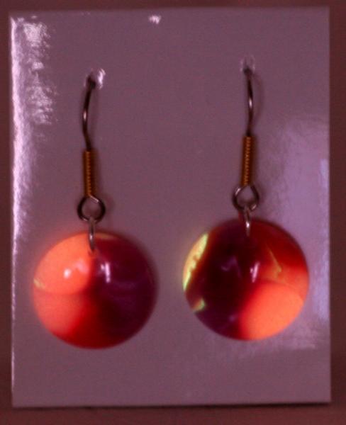

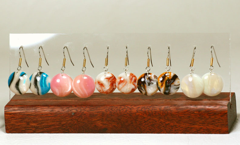

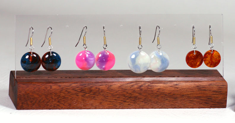

I made the mistake of playing around with alternative uses for pen blanks and came up with earrings. My wife has had me chained to the lathe creating a variety of colours. These were turned by holding the pen blank off cut length ways in the pin jaws and doming the end, polishing and then parting. This process is repeated for the second earring disc. One pair was from a glow in the dark blank.
