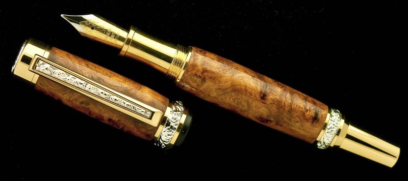

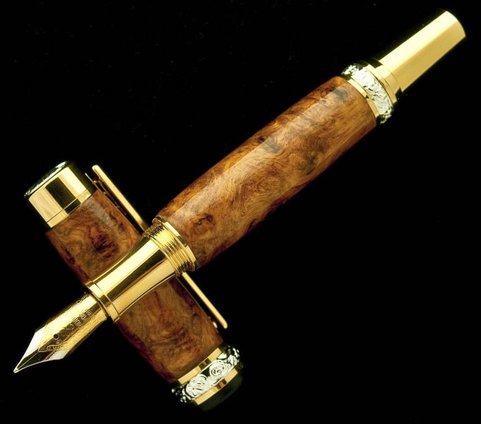

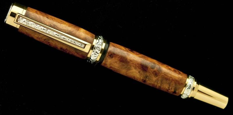

Made it this really early this morning.:eek: I had my trusty IAP mug by my side along with a pot of coffee. It's Amboyna Burlwood on a Gold Cambridge Fountain Pen with Sterling Silver Accents. It was a little dicey at first because I used a 3/4 inch X 3/4 inch blank rather than a 7/8" X 7/8" which I normally use for this size pen. Turned easily, sanded to 600 grit, cleaned with alcohol gauze, CA (medium) X 8 coats; MM, wet, to 12000 followed by HUT Plastic polish. It was nice to finish this before work this morning. Hope you like it. Comments welcome but most of all thanks for just looking. Have a good day! Doc:)

Beautiful like all your pens Doc! I'm a little iffy on if I like the Cambridge, but I think your work can make any pen look great! :biggrin:

Nice work Doc! That Amboyna really looks great with that hardware. I get up around 4am everyday too, but I go pee and then back to bed.:biggrin:

What a nice morning therapy session you have there Doc. The pen looks great! I know what you mean on the 3/4 blanks on a bigger pen, it can get scary. However you pulled if off and pulled it off very well. I am going to have to get me one of those kits some day in the near future.

Had to look at this thread since it had the word "therapy" in it... Beautiful pen- the finish on the kit really brings out the gold tones in the blank.
