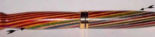

These pics are of some straight Dymondwood that I and glued up to produce a diagonal pattern . When I do the glue-up I always use "Hot Stuff" glue and I've not had any problems with them at all .
The pics are from 2 different colors of Dymondwood that were glued up for a diagonal pattern .
Both sides of the same pen

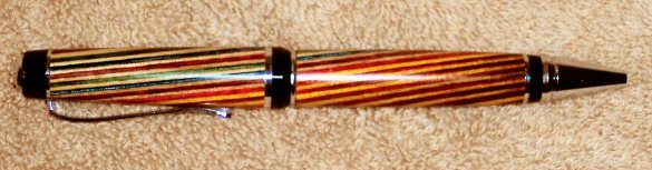

Cigar done from the twin of the one above .
