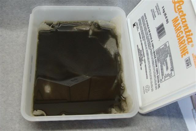

Four pieces of veneer cut . two cherry and two birch.
Soaking in solution with paper towel on bottom and between each piece and on top.
Covered with lid and waiting for complete saturation.
