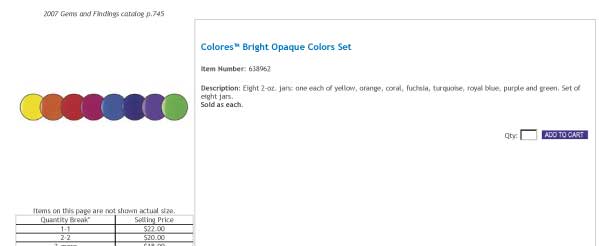

Rio Grande has variety of colored epoxy resins under the COLORES name & Red is part of the neutrals set. It mixes 2 parts resin to 1 part of their hardener.
