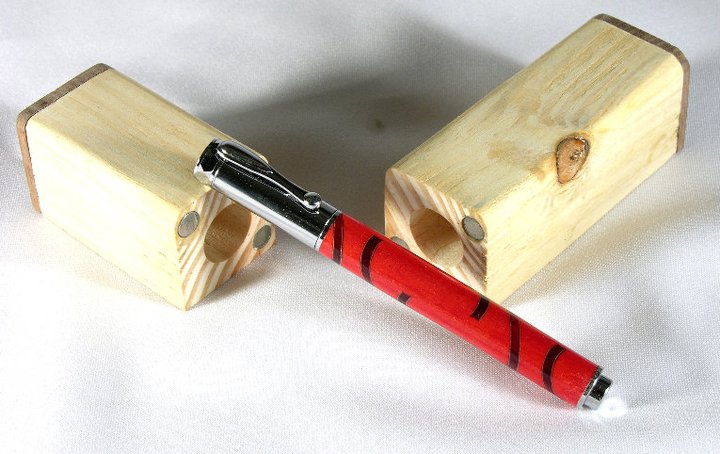

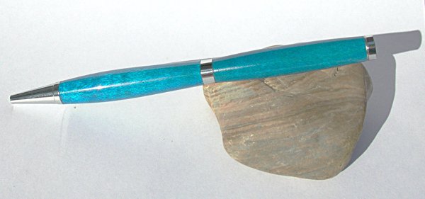

I've dyed my own wood with food coloring, left if to dry for a day, then put a CA finish over it. I've heard some say that the color will fade, but I've had a few for about a year with no apparent fading yet. I don't dilute the food coloring at all, just dripped it onto a paper towel and rubbed it all over the blank after final sanding.
