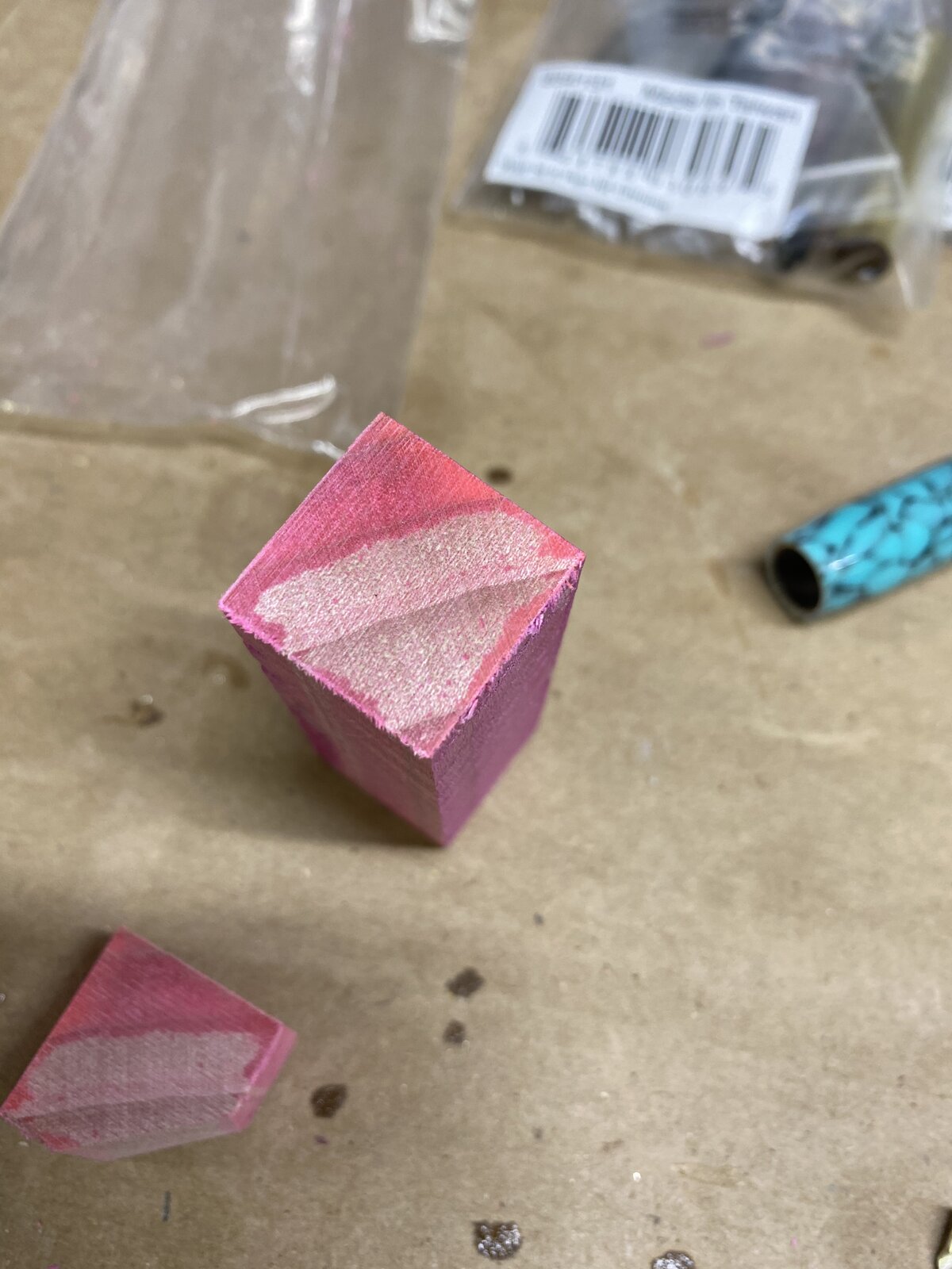

Hi All, I have a question about dyed blanks and if this is normal (and if not if I should try to return/ask woodcraft for something else).
Yesterday at my local woodcraft, I purchased a hot pink curly maple pen blank. It's HIGHLY figured (it's really amazing looking) but as I went to cut & drill the blank yesterday, I noticed that the pink dye only made it into the blank about 1/3 to 1/2 of the way thru the wood & not evenly. I cut the blank in half to prep for tubes and I saw that the dye went thru on a diagonal and so half the blank is a pink triangle inside and the other half is basically plain maple. I sanded down a mini chunk of it and the inside is plain maple with a hint of pink fibers.
This pen is for my grandmother; she is turning 94 next week and flamingo pink is her favorite color. I had wanted to make a slimline (because it's light and has more wood showing than a heavier Wall Street 2 pen) but if I turn the wood down to a slimline size, there will be NO pink showing on the wood. I don't want to use an acrylic pen blank because my grandpa, (her late husband), was a woodworker and I want to present her with a wood pen as an homage to him as well.
Does this happen with all dyed pen blanks? Should I go in to woodcraft today with my cut up blank and show them my issue and ask for a new one (or is this a "you get what you get" gamble type of purchase?) I understand the density (& amazing figure) of the curly maple can make dyeing difficult, so maybe a spalted tamarind would be a better choice?
I don't have any means to dye my own blanks (at least right now) and I need to get this made and mailed ASAP so I don't quite know how to proceed. I have some hot pink Wilton gel food coloring that I might be able to rub in to a complete blank before sealing, but that kind of defeats the point of spending $9 on a pink blank.
What are your thoughts on trying to take it back and choose something else?

You should take your blank back to Woodcraft and request a replacement. I expect they will happily do so.
From my experience all maple dyes very nicely through to the center. It can be made to dye to different consistencies to create a weathered or worn look but should be so noted. By the same token, any batch of dyed blanks could have a stinker in it that was not dry enough or didn't take dye well.

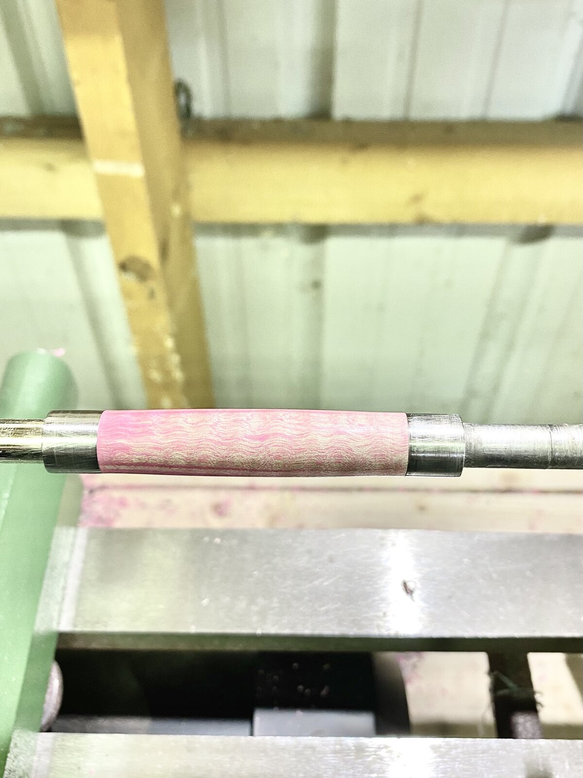

It's "pretty" and all... but not the all over hot pink flamingo look I had thought I was buying. And this is on a "Wall Street" bushing. If I had turned it down to a 7mm slimline tube there would have been even less pink! 😬

I have had good luck with buying artists oil paints and thinning them with DNA. You don't need the expensive paint, cheap will do. Turn it to size apply the dye and let dry.

I did some trials with alcohol inks and was impressed by the result. Took a few drops on a blue shop towel and rubbed over the turned blank. Took a ordinary looking maple blank and made it look impressive. Not sure how the HUT finish will react with it though.

I dye a lot of maple. I start with undyed curly maple blanks, turn and sand the blanks to "finished "size. Then I dye them while on the lathe, spinning at lowest speed, with literally whatever I have on hand - food/cake coloring, Magic Markers, Trans-Tint, artist water colors - whatever. Let the dry for a day or two, then LIGHTLY sand with equivalent of 000 Steel Wool, eg the MicroMesh or the Miralon equivalents; I use Miralon Black followed by Miralon Tan. Follow that with Pens Plus or Dr. Mahoney's Utility Finish; don't need to use CA!

From the picture, it looks likely that blank floated when it should have been soaking. I think a return is in order , especially with the photo. Just sent you a message for a possible alternative.

From the photo that is what I would call a weather or distressed dye job for a through dyed blank. I like the look on some applications.
The level of penetration you see on the pink corner is achievable all the way through on a dyed blank of maple. Some woods are more difficult and some colors are more difficult to get complete penetration but not maple and not pink. That is an easy combination.

I did end up going back to woodcraft today was told that the blank was defective (pretty in it's curly ways but was supposed to be all the way pink). We grabbed the last one off the shelf ( it as curly of course!) and he cut part of the end off and it was pink all the way thru. So tomorrow I will see what happens when I turn it!
