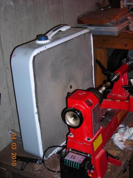

the furnace filter/fan idea
I was looking for this item online and came up with nothing. Does anyone have a link or pics I can see??
Given that I don't do that much turning YET, this maybe what I do for now, but I am having trouble believing that attaching a good filter to a cheap box fan is effective at all

Hey Dave, here is a pic of my box fan with filter. As you can see I have it placed right in front of the lathe mostly when I do my sanding. Otherwise it is up high blowing around for about an hour or two when I am done.
The filter is a reusable electrostatic filter designed to remove "microscopic dust particles" here is the link http://www.homedepot.com/h_d1/N-5yc...splay?langId=-1&storeId=10051&catalogId=10053
The box fax is an el-cheapo fan. All I did was cut to fit the filter and sewed it on the back of the fan. Nothing great, but it seems to work for now.
