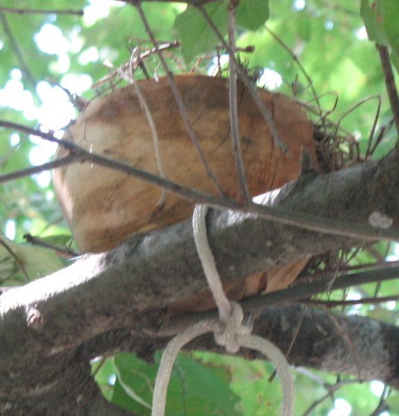

The bowl in the tree did use the band saw to trim off waste. Wood was on the ground for over a year. A catch landed that bowl in firewood bin. Baby Mockingbird and nest fell from tree one evening. I put baby back in nest and placed at bottom of tree. Next morning baby still alive so drilled some hole in bowl tied to tree, put baby and nest in bowl. Mother did return to feed baby, baby now a big bird and flew away.
